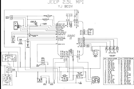

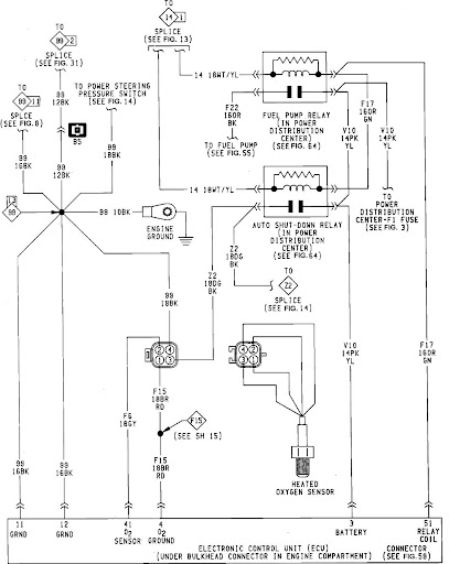

I cut off 2 O2 pigtails. One from a cherokee and one from a Yj. I can find neither in my yj manual. So i need help id'ing the wires so i know which to hook to my O2 wires.
My wires are DkGrn/blk, brn/red, blk, and gry.
Heres both pigtails. Either one will work. If anyone knows which wire goes to which pin, i can figure out the rest. Thanks. :)

« Reply #1 on: April 24, 2010, 10:34:50 AM »
What's the year?

« Reply #3 on: April 24, 2010, 11:18:57 AM »
Alright. Kewl. I think i might be able to put figure it out from that. Thanks. :)
