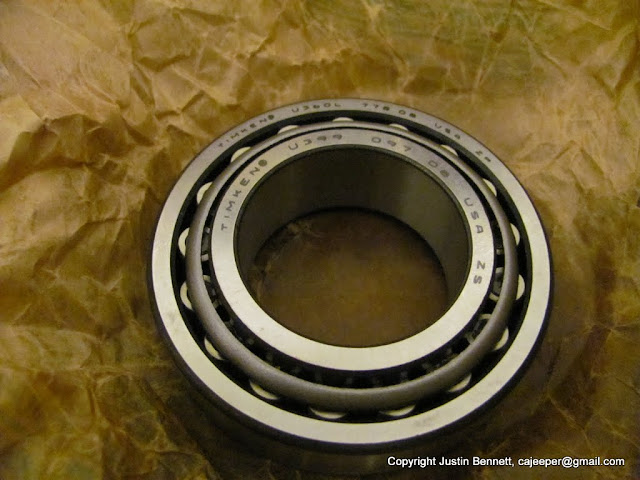

The whole pot full came today. Installing it all tomorrow. More pics to follow.
Noticed the race is now part of the bearing as one, not in 2 pieces (Timken.)
  • Chief Squirrel Blower®
Re: Bent Rear Axle
« Reply #12 on: September 09, 2011, 11:41:13 PM »
so it's not conical bearing then?
Re: Bent Rear Axle
« Reply #13 on: September 09, 2011, 11:50:46 PM »
It looks tapered (conical), but the race is not removing.
Offline aw12345
  • Posts: 3065
    • my jeep picture page
Re: Bent Rear Axle
« Reply #14 on: September 10, 2011, 05:02:39 AM »
That is how the bearing looks, it's a set 10 bearing and that ring holds the bearing together
