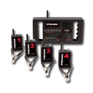

So at idle under load? Idle neutral vs. idle in D or R would be a hair different RPM. Either way, I'd poke at it with one of those sticks (mechanic's stethoscope).  :stick:  A lot of times it will amplify a noise you can't normally hear or under only certain conditions. Drivetrain noises are a lot more tricky.
My work's/school's (I work at a college) automative department has the wireless electronic kind that I used back on my old YJ to isolate bearing failures. It's a more expensive option if you don't know anywhere to borrow one. I keep stairing at it as one of those wants, but don't needs. Really helps if you get OCD finding squeaks and sounds (like me.) http://www.amazon.com/Steelman-STE97202-Wireless-Chassis-Ear/dp/B00123J79O
