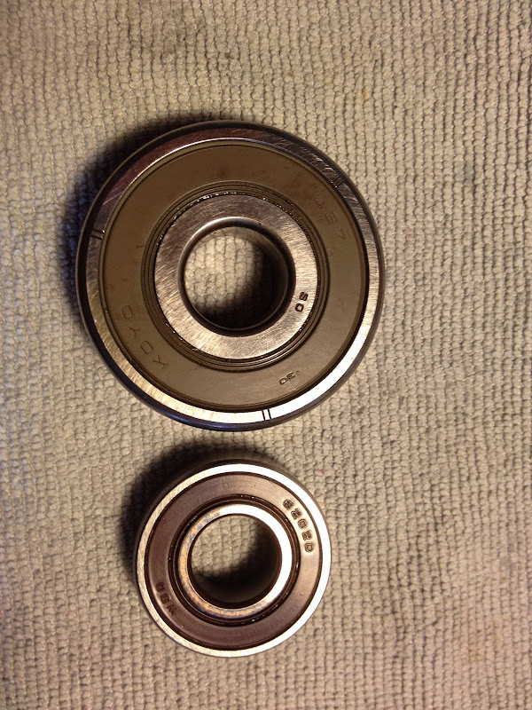

Well, I found out the rear bearing is original.  Also, taking the screws out was a PITA.  I ended up having to push the brushes in to clear the rotor without removing the brushes and rectifier.
I measure 15mm ID x 35mm OD x 11mm W for the rear and 17mm ID x 52mm OD x 16mm W for the front.  The front bearing is a KOYO 437.  The rear is WBD 6020D.  Looking up the numbers on the small bearing, I get this;

The small bearing has some play.  You can hear it when you spin it.  The big one feels like it's spinning in molasses.  I don't feel any rough spots but its not spinning freely.
There are a bunch of places to get bearings.  Ebay, any alternator rebuilder, bearing supply, etc...  Even Napa has some.  Although they're a bit overpriced.  The big bearing goes for $15-30.  The small one $8-10.
