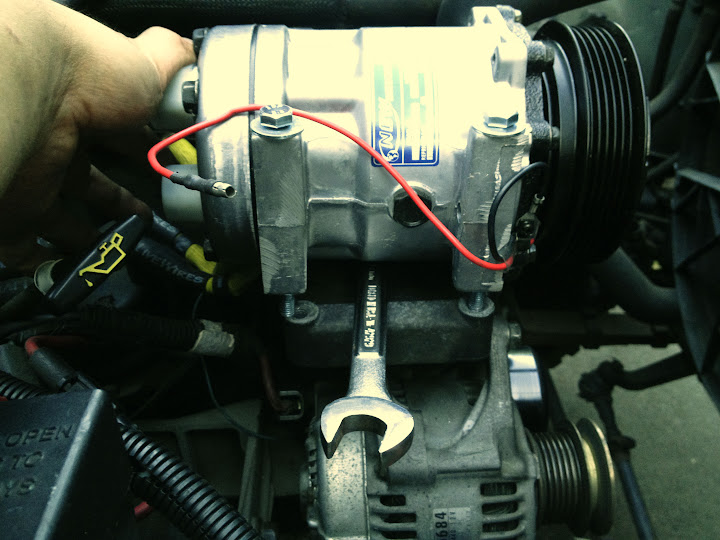

Since, I bought the compressor-less kit it came with a universal hose set which required the hoses to be cut to length and crimped.  This was a good thing because the hoses need to go around the York compressor for the OBA and the pre-crimped set don't account for this and would need some tweaking anyway.  You'll have to either arrange with an A/C chop to crump them or do as I did and buy a crimper.  I recommend getting the crimper.  (I'll get into that in more detail later.)

Because I bought the kit without the compressor I had to buy the hardware for the compressor myself.  These are metric bolts and had to be special ordered from www.fastenel.com.  The stock bolts are 8.8 1.25x100mm.
The compressor goes on only one way.  The distance between the bolts is different so if it doesn't line up flip the compressor over.

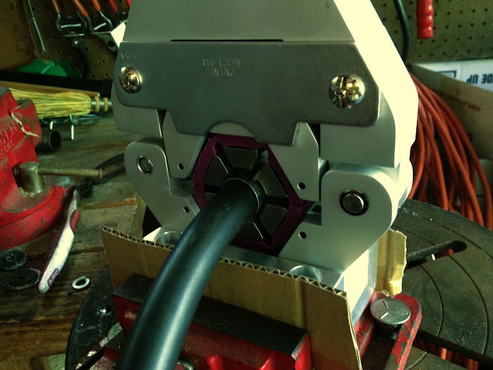

To crimp the fittings I ended up buying a MasterCool 71550.  I found Amazon.com to be the cheapest place to get it.
Make sure you read the instructions.  I found that going a little over the recommended line kept the hose from leaking.  If you get the universal hose, I also recommend paying attention to the clocking of each fitting.  If you do this correctly the hose won't bind.  What I mean is if you take a hose and twist it it will eventually want to coil onto itself.  To prevent this make sure the fittings are aligned with each connection.  Otherwise you could run into problems if two ends are angled in opposite directions.
