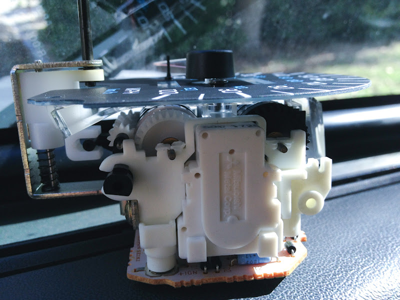

I guess I'll post these pictures since I have them.  I still wonder how the ECM is triggered for 82,500 miles, I can't believe it's on just a timer, and why mine triggered at exactly 86,600 miles.

are you trying to figure out if it's triggered by the speedo/odometer?
Re: Maintenance Light
« Reply #13 on: November 05, 2012, 09:12:04 AM »
I was then I just pulled the bulb and put everything back.   :lol:
« Reply #14 on: November 05, 2012, 01:25:07 PM »
yeah, the YJ dash is completely analog and i can't see them implementing a mechanical trigger even in the 90s for that, just wouldn't make much sense :lol:
