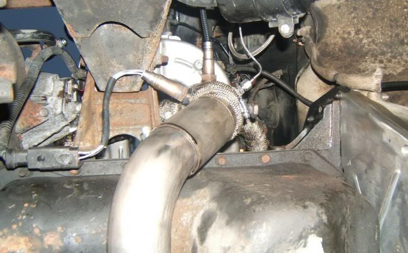

so last week i thought I broke another exhaust header bolt, not so, tightened all of them and still sounded like a tractor
so this weekend I took out the pacesetter header and downpipe
I found this
I had a Borla Stainless header i boght a while ago, it's not bad but not top notch either, it was for the TBI engine, it had the EGR and hot air thingy so i had to remove both. When i bought it i noticed the downpipe was 2'' diameter, stock is 2.25 - i figured it's time for an upgrade so i bought a J and a U Stainless 2.5'' mandel bent pipes. I also wanted to reroute the downpipe in front of the oil pan sump as i really didn't like the way it was between the sump and the transmission. I added the wideband and pyro bungs to the header as well.
This is the result of 2 days of work (i still need to wrap the downpipe, next weekend probably).
this picture is with the downpipe just hanging there but not tightened, it sits up higher
these are the way it sits, took the pics with the engine running - i was checking for leaks - I really like the Vibrant stainless clamps, they are rock solid but you need to be lined up dead on or will pull the pipes. I had everything tack welded together and they cut it in 2 places and put the clamps.

  That heat wrap may have caused the break in the old header.  Not sure why but it seems to make the metal brittle.  Had them wrapped on my old truck and had a good set of Hooker headers that were wrapped.  Dropped a wrench while working on the truck that broke the header open.

Very nice!  :thumbsup: I have heard that the wrap traps moisture. Can lead to the pipe rusting faster. Might not be a issue with stainless.

there is rust on the outside surface no doubt, but still shouldn't have cracked like that. the grade of steel they're using is sub-par.
this time i got lava wrap, not sure why the hype about it but to me it feels like the fiberglass i used before was shielding better. The thing i like about it is that you don't need to wet it to get it to form around the bends and is not as bad on your hands (i didn't wear gloves and was ok).
I hope this header won't crack.
One thing I'm happy about is I can do an oil change without having it all over the exhaust

i got the downpipe wrapped and used some Thermo-tec mylar shields to protect the oil pan, will take some pics in the following days. I'm really liking the mylar shields, i can actually put my hand on it which is not the case with the wrap so hopefully will keep some of the heat away from the oil pan.

I'd add a cooler if oil temp is the concern..  I've always wondered how the tj style exhaust wraps so close ot the starter and does not cook it...

i have an oil cooler.... just didn't hook it up yet (i have the adapter too but didn't get around to install it)
regardless of the routing either between the pan and transmission inspection cover or in front under the pan the exhaust radiates significant amounts of heat to the oil pan, the only better alternative would be under the transmission but then you heat up that one so really its no better not to mention the exhaust hanging another 2'' lower.
I still didn't get to take pics of the mylar shields, hopefully will do that today.
Re: Exhaust header and downpipe
« Reply #12 on: August 11, 2013, 09:06:48 PM »
here's the mylar, works pretty good - had it running today at idle for about 15 min and out of curiosity put my hand on the starter, it was cold to the touch.

i have a second one that goes all the way to the muffler, however i would have preferred a wider one for on top of the cat as it's too small and sits flush on top of it - the idea is to have some space in between to isolate properly. it made a small difference though but still gets hot - i think there best would be to also have a screen like above the muffler with the mylar under it so it's screening but is away (without contact) from the cat and pipes.
