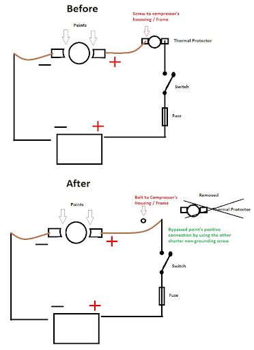

I burned out one of these air compressors when mounting it to my inner fender of my Wrangler.  What I found out, after frustration and a few cuss words, is that I think they booby-trapped this unit.
First off, the base plate is metal but is isolated electronically with rubber feet on the bottom plate and rubber bushings that hold the motor to it.
Second, the thermal protection device has the point lead wire connecting to it via a grounded screw.
I took mine all apart, since I couldn’t return it to Harbor Freight all hacked up, and discovered the grounding screw.  I removed the thermal protector, since I burnt it up bypassing the fuse :fitz:, and connected the positive point lead to the positive wire.  Buttoned it all up and I'm good to go.  No more short.  :blbl:
Here’s a diagram, based off my memory, of the before and after configuration.
I would imagine that it would be in their best interest to booby trap these if the company making them made another version that you pay more for that is meant to be mounted in a vehicle.  That’s just my hunch. ;)
Hope this helps.
-Justin

I would have bought one year and half ago over the harbor freight had I known.  Curious if the postive lead is also grounded to it's frame.  ;)
