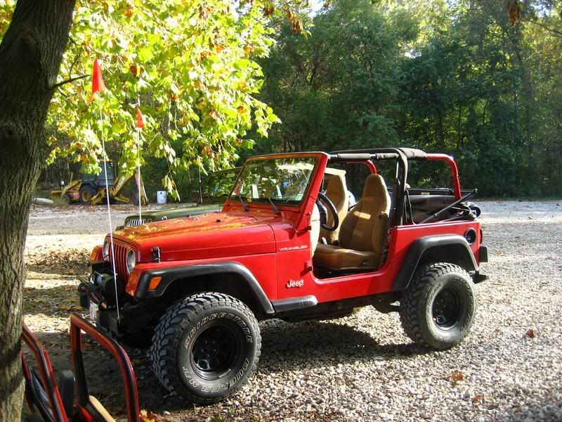

This Jeep below is in my club, he is running a 2" body lift only and has 33"s on it, he has since changed it.
He is much happier with a 4" lift and no body lift.
