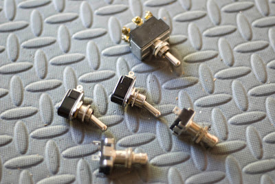

Spacing will really depend on the switches you use.  I chose Medium and Heavy Duty AC switches.  I liked the industrial toggle switches more then the rockers or cheap DC switches you normally find.  These are better quality and have a higher amp rating as well.  For this project, I went with two 'Single Poll Single Throw' (SPST) On-Off.  These control the OBA Compressor and the Electric Fan.  The next set of switches is a push-button SPST On-Off to activate the next switch.  It is a Double Poll Double Throw (DPDT) (On) - Off - (On) Momentary.  It controls the winch which is why it's a momentary switch.  The next set of switches are a SPST and a Double Poll Single Throw (DPST).  These control the lights.  The DPST controls two separate bulbs in one light.  It could also be used to control two different lights as well.
