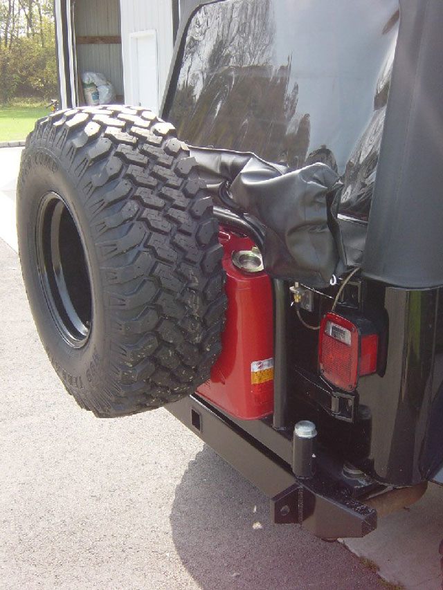

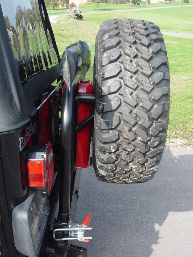

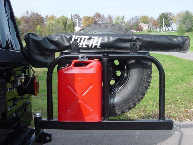

I'm liking this setup.
http://www.jeepforum.com/forum/f43/treks-tire-carrier-tj-lj-cj-models-805452/
Jesse-James
Re: Rear Bumpers
« Reply #19 on: December 16, 2009, 11:17:54 PM »
That is a sweet setup!

« Reply #20 on: December 17, 2009, 05:07:04 AM »
Is a nice setup if you use rear corner armor and backup plates on the inside.
Savvy now sells rear aluminum 6160 T6 corner blanks for YJ's for 299 is a hell of a deal. The material alone is over 200 bucks
2006 Jeep Wrangler TJ SE
2004 Jeep Wrangler TJ SE
  • Posts: 3595
Re: Rear Bumpers
« Reply #21 on: December 17, 2009, 08:41:32 AM »
That is pretty nice.  A good feature would be for the gas can shelf to be removable.
Re: Rear Bumpers
« Reply #22 on: December 17, 2009, 11:50:45 AM »
Their kit uses backing plates as reinforcements.  They say without corners you can run up to 37's.
And the gas can mount is removeable as it's optional.  The tire also has several mounting locations as the plate has several different holes drilled.

It's kind of strange that Treks doesn't list that carrier for the YJ. You would think it would install about the same as on a CJ.
Re: Rear Bumpers
« Reply #24 on: December 17, 2009, 02:35:55 PM »
My guess is this;  The CJ does not have side hinges.  If you look at the TJ above the rack seems to be using the side hinges as bolting points.  I'm sure the upper hinge is also tied into the rollbar which the CJ does not have in the same location.

look at how clean the inside of that wheel well is...christ...
2009 Audi S5....what....its 4wd...sort of....
Re: Rear Bumpers
« Reply #27 on: December 17, 2009, 07:35:19 PM »
Well, yes they washed it.
