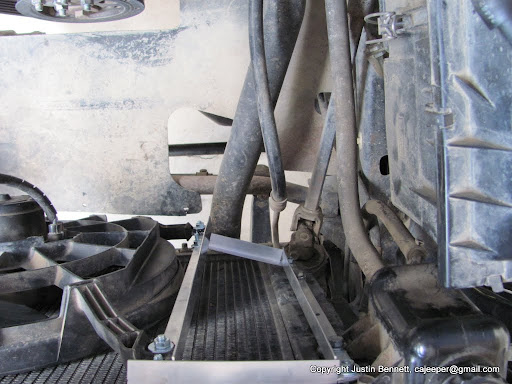

Here's the fan installed:

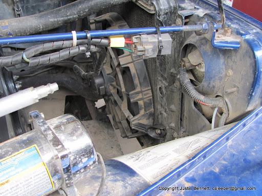

Here's Where the old fan was:
Here's the donor's relay:

whats the diameter of that fan? looks kinda small compared to what other people use... could also be that it doesn't have a big shroud like the ford ones.  always nice to get a free mod.
I put it next to the stock fan and their identical size.  There was no shroud to pull off the donor vehicle and that's how it was mounted, I just turned it 90 degrees CW to match my holes.  I thought the same thing about the shroud, but since it was the same size and on a v6 with A/C, I wasn't too worried about heat.
It's only a single speed fan, but it sure keeps it cold.  I turned it on and you can feel the air rushing in from the front of the grill.
Good question!  Thanks,  :thumb:

The size does not worry me as much as (1) pulling power (I know the Ford fans are a beast at moving air; dont know about this one, though), and (2) the fact that you are not using a shroud.  Without a shroud, the fan will only cool the air directly in front of the fan, which leaves a lot of the radiator not cooling, and this will be more of an issue when wheeling (using the 4L), as less air goes through the radiator at low speeds, and the engine tends to be revved more.
I live in a desert area, so I'll be sure to report back if there's any issues on a hot day.  I would have rather got the Taurus/Mark V fan, just wasn't the free one.  ;)

i think you'll be fine with no shroud, one thing i think you should consider is the way you made the mount on the driver's side - that aluminum just between the one side of the fan housing and the rad bracket i don't think is sturdy enough, it might let the fan vibrate and hid your radiator  core, i would consider going with the aluminum angle all the way across between the rad brackets.

« Reply #6 on: April 12, 2010, 12:36:50 PM »
When I get a some time this weekend, I'm going to make a second go at it.  I was running out of day light and made some what of a hack bracket  :gimp: just so I could drive it around.  It doeesn't move to much even though it's so oogly.
I'd also worry that the aluminum would fatigue from vibrations as it doesn't look like it's mounted too solidly.
Here's what's going down...  :uhoh:
Going to take this :crap: off and going to use it as a template.  Make a better version of my :asshat: and send ya'll some pics.  I'm also going to extend the top bracket all the way across to connect to the other side of the radiator for more strength.  Hope to have it done in the next or so.  Untill then, have a beer :beer:
 - you should have the same for the bottom bracket (all the way across).
 - don't cut the angle side when you meet with the vertical one, that's what provides strength and prevents it from bending

If you run two horizontal runners all the way across the radiator you shouldn't need vertical supports on the sides.  Then run your one vertical for the dr. side.  You'll probably need a tube so space that lower mount since it's not flush with the face of the fan like the other points.
Also, don't limit yourself with the stock mounting locations of the fan.  You can always add L brackets so it sits flush with the face of the fan.  The fan is pretty light so just a few screws though the plastic would do.
