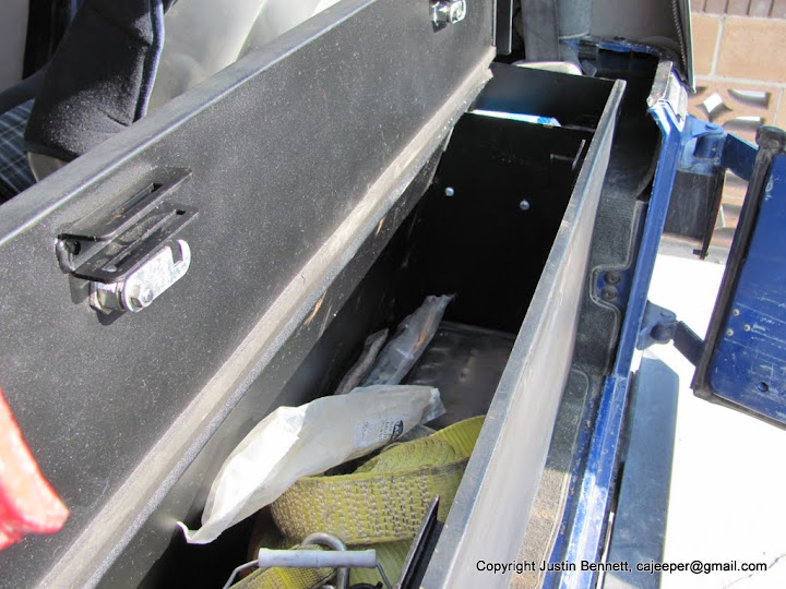

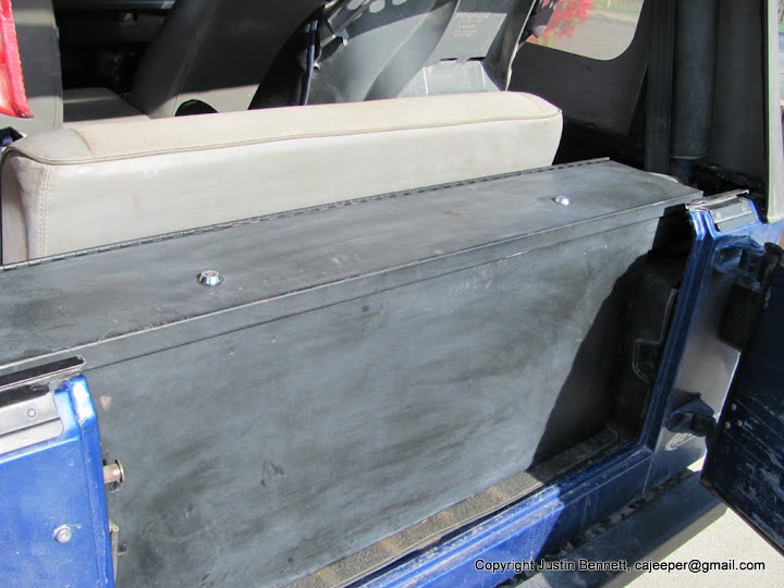

Just sold my OEM bumper and tow hooks on Friday for $40.  Saturday, I came up on a Tuffy Rear Security Box for $40.  I bugged a few a you a while ago about making a lid, which I still have the material to do, but I came up on this deal before I got around to it.  Thanks for your time.

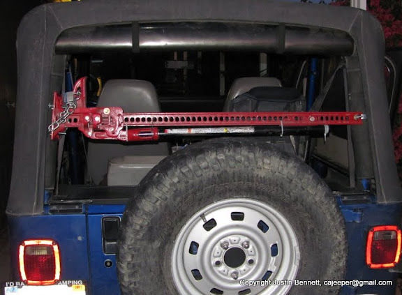

I had the hi-lift laying on the back behind the bench seat chained to the roll bar.  When I threw the box in it started rubbing red paint everywhere.  Read some posts about mounting the hi-lift to the roll bar and grabbed two 2.5" muffler clamps and some bolts from my father-in-law's shed.  Wala, another ghetto build by yours truely.
Some final thoughts, I need to run to the hardware store and get some wing-nuts (his shed was all out) and not sure how long the grade 8 cotter pin is going to hang in there on the base plate of the hi-lift.  If I get one more muffler clamp, I think I can even out the base plate so it so I don't have to worry the cotter pin snapping.

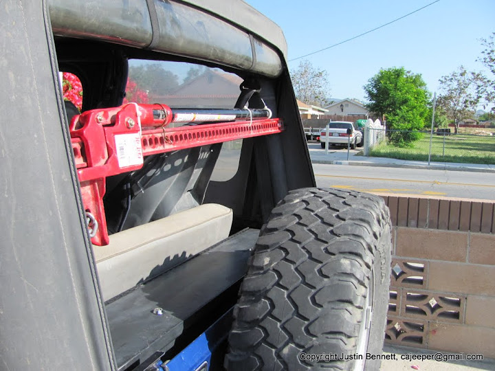

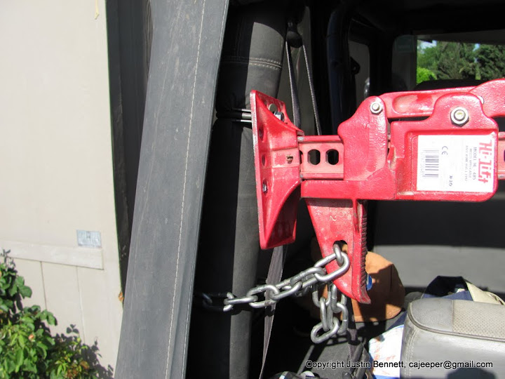

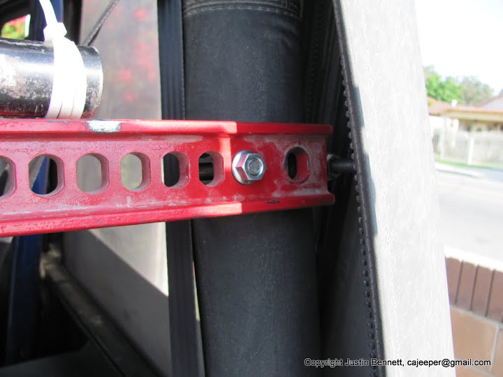

I installed mine using fencing hardware which I hit with a rattle can of bedliner (just for looks).  I am quite happy with the results...
Here are some pics:
Felipe
Re: Tuffy Box and hung the Hi-Lift
« Reply #6 on: April 28, 2010, 09:15:58 PM »
Nice, thanks for the pic's posted!
I think I might do the fence post bracket too.  Then I don't have to contend with the one bolt dragging across the seat belt.
