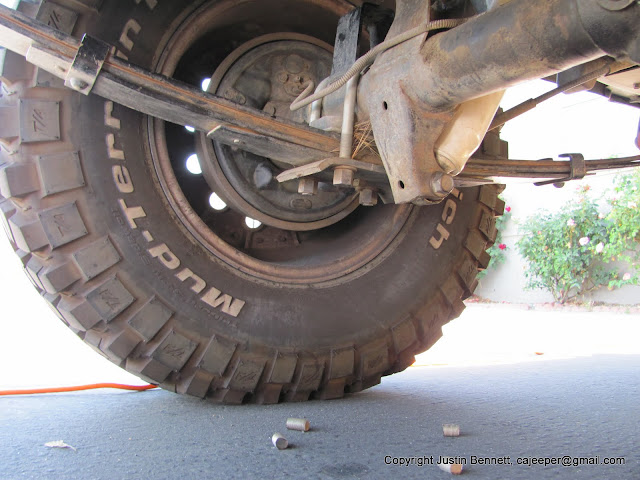

The leaf spring was binding against the retaining clamp.  I thought for sure it was the culprit, but nope.  If you look below, you can get an idea of what I mean.  They're attached on the 2nd smallest leaf to keep the pack from stretching to far or something ???

Got right up against my wall in front of my house, and the noise is coming from the rear passenger side for sure.  That means the track bar is out.
Started pushing it in neutral on level ground through the gutter and into my driveway.  The rear bushings on the leaf springs are making noise, squishy squeaky, but not the main complaint.  The bushings are out (even though they could use some grease).
That leaves the shocks... but this is way too loud to be a shock.  My sinking suspicion is this noise is coming from the axle and more specifically the passenger side tube.  I'm going to go to the autoshop at work and grab those Matco Chassis Contact Microphones (http://www.matcotools.com/Catalog/toolcatalog.jsp?cattype=T&cat=2306&select=&page=5) and give it another go.  Sigh...
