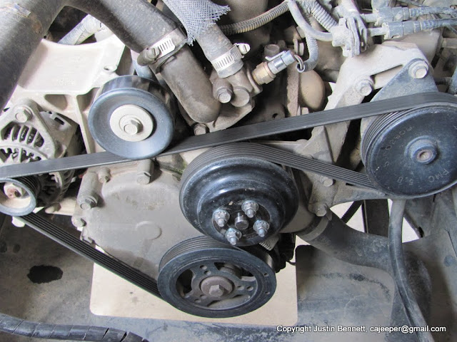

So I finally decided that the time had come to put in the Flex-A-Lite 485 that I've had sitting around for five months in the '01. I got the control mounted and all the wires pre-run. When I went to remove the stock fan, I discovered that the shaft that the fan mounts to is actually joined with the water pump pulley so that it is one-piece. Any suggestions on what to do now?

Take the whole clutch housing off with it.
Re: Fan
« Reply #2 on: October 21, 2010, 08:15:48 PM »
it's not joined with the pulley, take the 4 nuts off and the clutch will come off, the pulley can be bolted to the waterpump just by itself.

« Reply #3 on: October 23, 2010, 12:56:38 AM »
Not sure what it's like on an '01, but here's my '95

You guys were right. I'm a moron that panicked before fully investigating it. Once I loosened the belt tension the fan literally fell right off.
