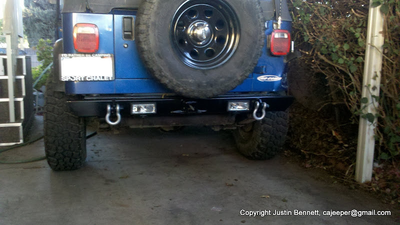

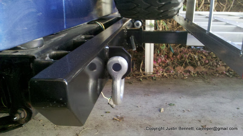

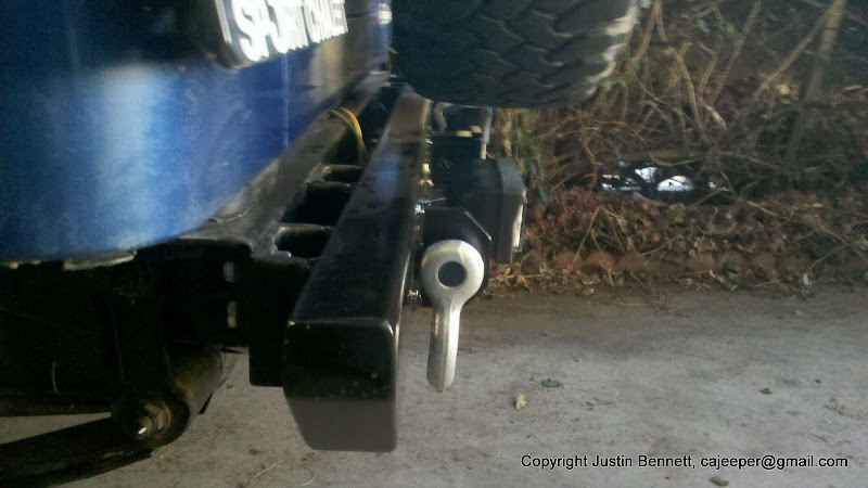

LAST UPDATE:
Put on the platform, jumped on it with my 290lb fat a$$ (Just in case it failed, I put it on video http://www.youtube.com/watch?v=vwgozXxWSHo); didn't hit the ground, so good to go.  I also placed the lights; they'll be wired up over vacation.  I'll post any troubles that I run into.  The cost creeped up higher than I expected, but I'm very happy and got what I wanted.
Total cost
$165 Bumper and bolts - The Dirtworx in Corona, CA (www.thedirtworx.com)
$28  Primer, Rags, 400 grit wet dry sand paper, Lacquer Thinner, and Mineral Spirits
$0   Black Automotive paint and application both from friend
$44  Reinforcement Brackets - RH2001-YJ
$28  (2) D-Rings - W/I2100
$20  Welding Brackets
$30  (2) KC 1762 Driving Lights on sale
$0   Relay, wire, and fuse - Already on-hand
$315
