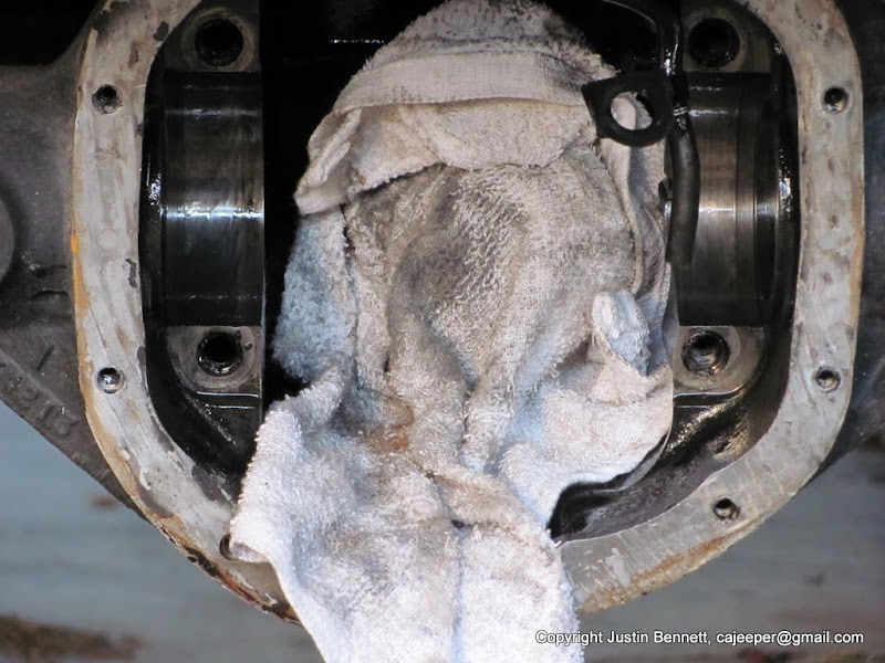

I replaced a blown out front TeraFlex lower arm bushing. I bought the Repair Kit # 1951000, and it came with everything except a tool to squeeze the new bushings and washers together. I figured I could get with sockets and spare crap laying around. 40 min in, I realized I had made an unwise decision and need a good snap ring tool before I do this ever again.
The axle seals came next. I got the hubs off, drained the gear oil, and pulled the axle shafts. I took a look at the shafts to see anything obvious to why the seal failed. I'm pretty sure I found my reason - passenger side inside of shaft splines are twisted. I put everything back together and filled it back with fluid until I can get a replacement shaft. No point in putting a new seal in if I may need to do this again.

Disassembled the front Dana 44
(Took some photos, but at this point it died. I need some new rechargeable.)
Installed two new inner seals
Reassembled the front Dana 44 with new replacement passenger side axle shaft
Put in some Redline 75-140w
Took off the ape-hiney-red diff. cover from the rear diff
Reinstalled the stock diff. cover with a new gasket and more Redline 75-140w
