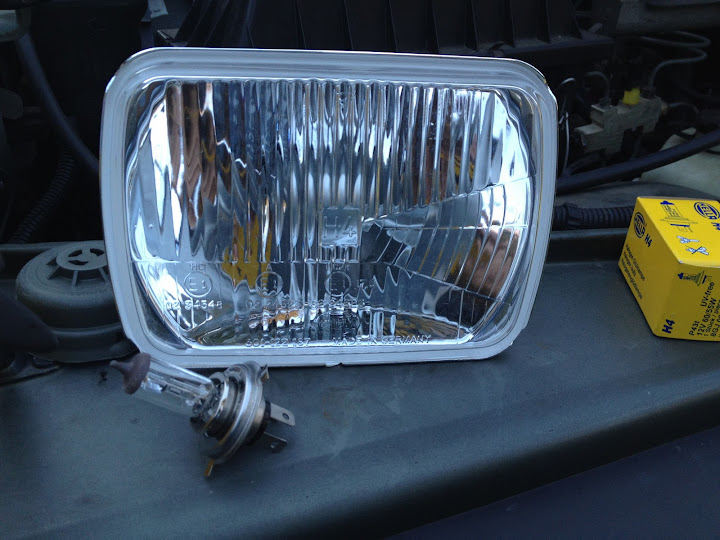

Out of the box, the housing are fairly light.  They reflectors are plastic but the lens is all glass.  Since the box has no packing in it, the tabs for the bulbs were a little bent.  Not really a big deal but if you don't pat attention, you'll spend some time wondering why you can't get the clips on or off.
The only tool you'll need is a phillips screw driver.  First start off by removing the headlight bezel.  There are 4 screws.
Once that is off, locate the headlight retaining bracket.  There are 4 screws holding it on.  There is also an adjustment screw at the top and on the outside of each headlight.  Do not remove these as your alignment will be out of whack.
Make sure you DO NOT touch the glass side of the bulb.  The oils on your fingers will cause the bulbs to have a shorter life span.  So make sure you only hold the plug end.  There is only one way for the bulbs to fit into the housing so there is no worry of getting them in wrong.  Once the bulbs are in, clip them down and install the rubber boot.  Make sure you push the boot all the way down so the prongs of the bulbs are exposed.  Then place the housing into the headlight basket.  Make sure it's seated evenly and reinstall the screws.  Threading each screw a little until they're all in then tightening them down while using an X pattern so as to try to keep the housing centered.
I didn't bother to align the lights but after trying them, it looks like they were spot on still.  Notice, the Jeep isn't parallel to the garage nor is it 25ft back.  :whistle:
Overall, I'm extremely happy with the lights.  They work so well that I have stopped using my aux. lights while driving.  I haven't been flashed and I can see.  They aren't super white but I don't think they really need to be.  The pattern is a lot more even and spread out, so I'm now able to see what's between the hot spot and the fenders.  The only negative I can see is that in the distance you can see a darker area in the center.  This gets worse with the high beams on.  Also, when switching to high beams, you lose most of the light between the hot spot and the fenders.  You could fix this by wiring the lights so the low beams stay on with the high beams though.
