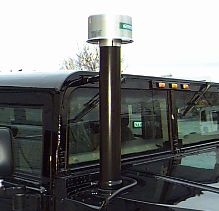

Do the Hummer snorkel......
Re: cowl intake
« Reply #5 on: March 31, 2007, 02:25:47 PM »
Wow, that's an awful place to put it.  The snorkel is an attachment that moves the stock intake higher up.  But since that's right in the middle it would be like having chimney there.  Not to mention it also means you'll never be able to lower the windshield.  If H had to choose, I'd go with monsterslayers setup and have the intake at teh end of teh cowl cover.  At least it's not right in the middle although it will won't allow you to lower the windshield.
Not sure what you mean by that.....as far as not putting the windshield down many people don't care. It is an option to us who wheel where trees are the enemy of traditional snorkels. Myself, I have bigger fish to fry before I think about a snorkel but may consider something like this when I do.
The snorkel attachment is a 4" dia tube that sits on the airbox.  The problem I see with leaving the top cap at hood level is that water will splash up on the hood if it's that deep.  If the vehicle is moving at a constant speed there is a depression which is caused by the bow/front of the Jeep.  This depression allows for the Jeep to go deeper then the height between the airbox and the ground...
So you're saying the stock airbox is better than having it on the cowl? I don't buy it. Water is going to splash on on it, that is why it's intake is on the bottom of the assembly. Gravity isn't going to allow it to take water the way you're thinking. I don't think it will take on any more water than a safari type snorkel. Raising it a couple inches wouldn't hurt, but it's still a logical choice for those that battle trees.
I'm not sure if better is the right word.  Perhaps no better.  Like I said, the wave will have a trough at the backside of the wave which will give you a little leeway.  If you're hitting the water fast enough or it's deep, the peak will rise higher then the baseline.  Which would then go over the hood.  (The front of the Jeep would still slow the progress of water.)
In any case my complaint isn't with the design as much as where he's got the input located.  It just looks bad.  The other thing I'm not really keen on is that there is no airbox to speak of.  He has what looks like flex hose going through the firewall into the cowl space to the cut off stock intake.  That would mean his filter is under the cap.  So if water did get into the intake, there is no holding area, it just gets sucked into the engine.
The other setup I've seen, which I believe was the first, had a airbox under the hood still.  This will at least hold some water back.  This is why ARB uses the stock airbox.  The input is low in the box but the output for the intake is high up.  This means the box would need to fill some ways before water gets ingested into the engine.  It's acts like a trap can.
