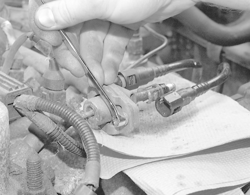

This is where I'm confused because my TJ rail does have a regulator on it and the return line comes off the back of that.
Like this
Like this
Interesting...  That's a carry over from OBDI.  The TJ shouldn't have a return and the fuel filter/regulator should be on the top of the tank.  I'm wondering how early this '97 was made.  Probably a transition so that would put it in mid to late '95 or early '96.  I've heard/seen of '95.5's with '97 parts but not a '97 with '95 parts.
If that's the case then I'd just an MPFI YJ pump with the returns.  Not to mention, you won't have to screw around swapping the gas level sender unit.  Otherwise, run an inline pump and leave your stock one in the tank.

I haven't had time to do squat these past few days but I did manage to order an in-line pump.
Now I need to know one more thing. In the picture below you see two fuel lines entering the fuel rail, one is a supply and the other is the return.
Which one is which.
Reason I'm asking is because the previous owner regulated the fuel at the pump not using a return and had the supply hooked up to the 5/16 line with the regulator input capped. Make sense? I assume the input is through the regulator but need to make sure.
Thanks
