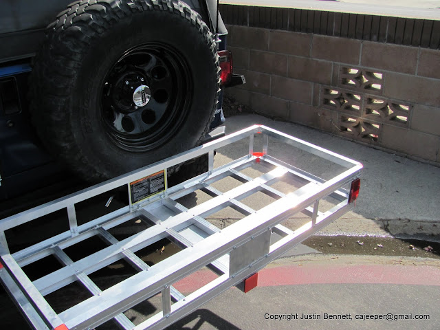

I'm looking at a new bumper for my Jeep.  I'm talking with thedirtworx, a local fabricator, to get a rear bumper.  Asking for the d-ring one with aux light tabs and an added frame support.  He e-mailed me back and said it should hold 500lb tounge weight and should be about $165 (unfinished).  I'm just going to rattle can it black for now.
I want to be able to stack my platform with wood and no worry.

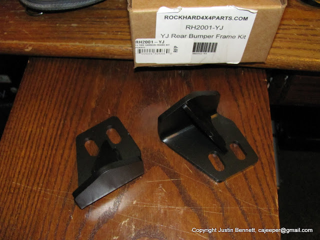

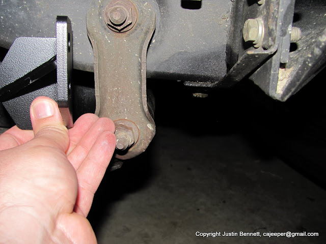

I'm bummed.  I just ordered a YJ Rear Bumper Frame Kit from 4wd.com.  The picture was of the TJ installed (bolts only), apparently after checking the Rockhard4x4parts.com catalog, the RH2001-YJ kit says (welding required).  Now I'm bummed.  Won't have this all put together for a while.   :brick:  I have to drop the gas tank, schedule and tow my pile to a welder, disconnect the rear leafs, ...
Brighter side, hopefully my bumpers ready for pickup tomorrow afternoon.

hmm that gusset looks very restrictive to shackle movement
that gusset would need to be trimmed for proper shackle movement. You will also need to grind off the paint/powdercoat before welding too. Looks like you could bolt it on once prepped and bring it to your welder person. I don't think the tank will need to be dropped or the shackle removed.
