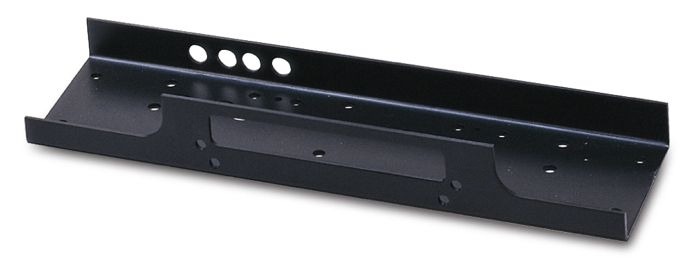

just bought a milemarker 9000
i am gona make my own mounting plate and was woundering how this should be done . I wound like it so it cant be unbolted easily as i would not want my new toy to get stolin . any help would be great
Alex
Re: just got a winch
« Reply #1 on: October 09, 2007, 11:48:06 AM »
Well, what is this for?  XJ, YJ, TJ, etc?  I'd just copy an existing mount.  No need to reinvent the wheel.
To keep it from walking off, you could do a few things.  Spot weld all the bolts and nuts in place or you could weld U channels over them.  Some people take 1" lengths of tube but you can still use a socket to get around those.  Another idea is to use non-standard fasteners.  Large torx or allen heads, etc...

Not much to it then.  Just measure the 4 holes in the frame.  Then measure the holes in the winch.  Choose your steel thickness and cut some holes.  If you don't buy a C channel or a L plate then you'll need to weld on a front plate for the fairlead then gusset it somehow.

I made my own winch plate out of 3/16 304 stainless. It's two seperate pieces welded together. There have been times when I was worried about the strength of my plate but it has stood the test of time. Just make sure if you replace bolts to go with grade 8

started it last night . ill try to get pics up . i just tore off my old bumper and boxed in the front of the fram rails .
it all out of 3/16 but is bolted to another piece of 3/16 braced down to the cross member bettween the frame rails .Then the boxed piece is bolted to the frame raild in about 6 spots
dosnt look like anything special but i just wanted it to be STRONG . and i like the way its just boxed with no bumper

befor
after . still needs boxed on the side and mount hooks and mount the fairlead but i thing its gona look nice , plain and simple looking
i mostly boxed it cuz it will look cleaner when i flat fender it , witch should be really soon
let me know what you think

heres another pic just cuz im bored .
nofearblackstar
« Reply #12 on: October 19, 2007, 05:52:53 PM »
DONE

That looks like it will do the trick plenty beefy

felt like some of it was over doing it but id rather do work now then have one hell of a time fixing whatever brakes .
