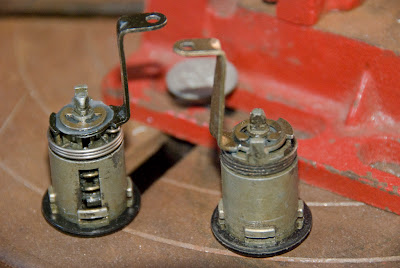

This is a problem with full doors only.  Cleaning then won't really work.  The Z bracket gets bent since there is too much movement between the bracket and the E-clip.  I made a plastic washer and it really firms it up.  The Z bracket doesn't rock anymore and pulls in both direction with no slop.  The only problem is the key won't recenter in the up right position till it wears a little.
This has been an issue for years.  Especially in the winter.  When it gets cold the links stiffen up even with no grease and the Z bracket bends because of the slop at the E-clip.  I've been locked out of my Jeep on several occasions where I couldn't open anything but the rear and had to climb in through the back.   :uhoh:
I'm going to have to wait a few days to see how it holds up, but I think it will be fine.  I have picts of what I did shortly.

Most likely, yes.  The Z bracket is really way too long and your twisting it at the base and 2" up the rod is supposed to be pulled.  Since it can rock, the lever gets bent which won't move the lever enough to unlock the door.

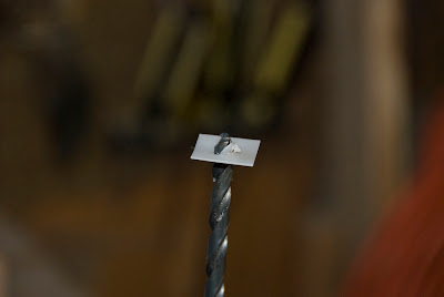

Ok, here's what I did;  got some scrap plastic that I had laying around and trimmed it into a square.  Then took a drill that was about the same diameter as the area on the lock cylinder.  I guess I'll make a formal write-up later.

I held the drill bit in my hand.  It takes a few passes since the drill will screw in instead of cutting a perfectly round hole.
When you drill stuff like that, just put a paint stir stick on top of it and drill through the stick and the plastic.  It's the easiest way to drill any sort of thin material.
