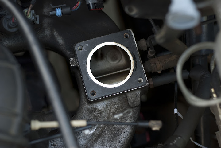

i was wondering if i was wrong or something since i saw that oldjeep said the same thing. I remember that on my intake there was no need to bore out. I have an intake from a '94 in the garage, so i measured it: it is 54.90 mm in diameter. I measured a 4.0L t/b and it is 55.50 mm,
so that would create a 0.30 mm lip around the bottom of t/b - that is 0.055'' or somewhere more than 3/64 and less than 1/16 - pretty small difference but there would be a lip there in this case. Could be what you say though as the one on the Jeep was at least the same size (or maybe the t/b was a bit smaller).

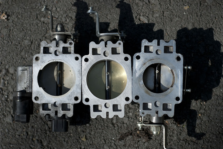

Minimal difference.  There will also be a gap where the gasket is since the gasket opening is much larger.
You can see the carbon/oil/goo ring marking where the gasket was.
In order: Stock 4.0L/ 64mm / 2.5L
« Last Edit: April 25, 2010, 03:02:55 PM by Jeffy »

Evidently there are differences in the manifolds.  My 91 manifold did not that that ridge on the bottom either but was flat on the floor of the interior of the manifold.  Even if there is only a small sharp edge of 1/16 it can cause quite a turbulence in airflow.  Turbulence helps with low speed torque (which isn't lacking with the 2.5 throttle body) but hurts in high speed horsepower which is what we are trying to help.

this is off two different yj's 4 cylinders
  • Chief Squirrel Blower®
Re: 4.0 tb conversion?....(sorry)
« Reply #12 on: April 25, 2010, 04:31:46 PM »
you're right, better without the lip sticking out - less restrictions, better flow.
i think your manifold is probably an older style.
never seen that left side before - seems a better choice - the one on the right is what i have, the portion right under the seat is rounded nicely towards the intake runs, how's the other one in that respect?
'91 must be a year into itself as mine is a '92 (built in Nov '91).  I'm going to guess the one that's not square at the TB is a late model. '95.
