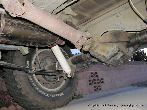

Here's what the stock cat looks like.  The bottom one is a Car-Sound/Magnaflow

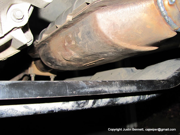

Here's the old turd cat...
Re: Exhaust - Banks Monster Exhaust
« Reply #4 on: May 24, 2010, 07:36:21 PM »
Yeah, that's a pretty ugly cat.  The comb is pretty tight too.  you can see here that you can see through the holes.  Wrong application cat for sure.

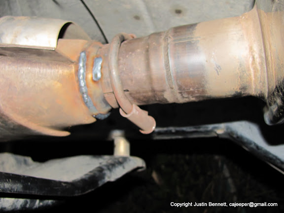

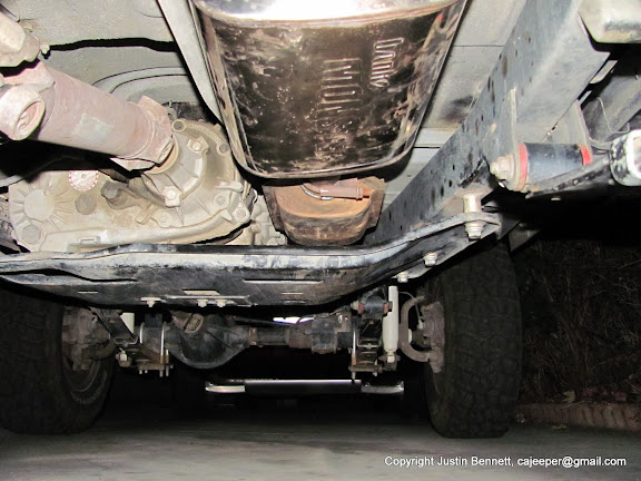

The system I got came with a cat and it has replaced the one pictured above.  I believe it looks like a Walker cat, but I'm not sure.  It was installed on a 93 YJ with a 6 cyclinder.  It supposedly ran great prior to the accident.  Seems to work better for me.  I just paid a local muffler guy to weld the crack in the cat.  I think it was from the accident.
i wouldn't trust it if it was in an accident (and also cracked from that) - the insides can brake and block your exhaust, rather buy a universal for $50 or so and replace it, would save you the trouble in the long run.
« Reply #8 on: May 25, 2010, 08:48:46 PM »

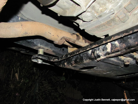

The crack was on the seam of a weld wear the pipe connects to the cat's body.  It's straight and the comb looks good on both end, not dented, neither is any other part of the system.  I already paid the $30 for someone to close it too.
I'll post some pic's after I'm done with my Del Taco Classic Taco's  :bandit:

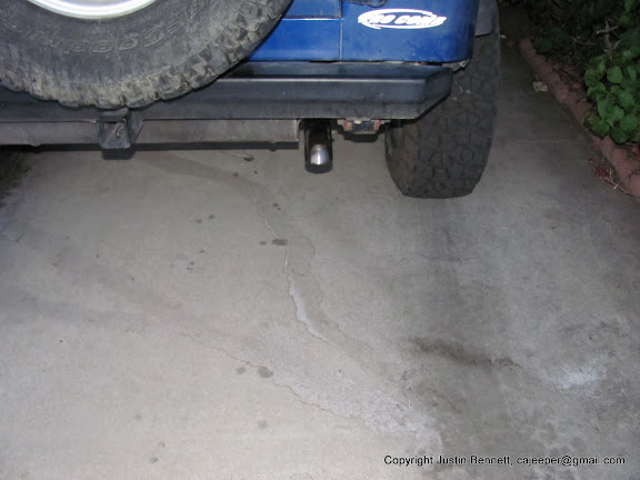

http://picasaweb.google.com/cajeeper/JeepBuildUp#5475410030824274786
Oh, and yes,  I removed the friggin rear track bar!!! :smokes:
