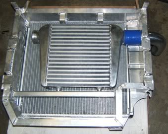

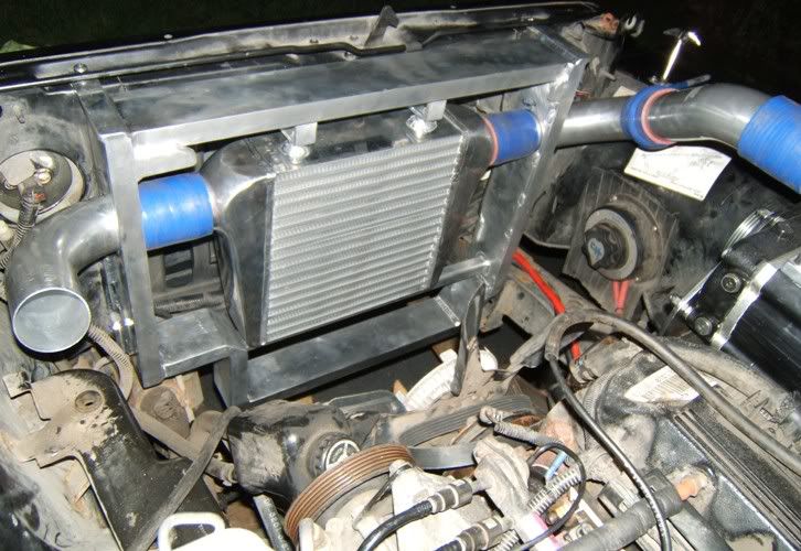

Its a space issue. I have to see if it fits and where to route the piping. Don't be surprised with a pic of a PVC piped intake at first lol. But ya that would be the ideal place to put on. St.chevy, you ever come to the states?
Re: Turbochargers
« Reply #313 on: April 06, 2010, 09:37:33 PM »
this is what i ended up with
